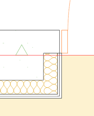

LeeJaeYoung
I am trying to create a door like the image above.
How to make insulation seems to be the most important question.
Should I start with a new question?
Or can I proceed here?
I am trying to study this GDL.
AC27 on window 11
It is an un-related problem, so best to start a new post.
But before you do, you may want to look at the reveal options and wall closure options of the door object.
LeeJaeYoung
This image is made with archicad primitives.
There are some parts that need to be modified very slightly, so I'm going to make it with GDL.
Hope you understand.^^
