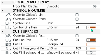

I want to use pen 6 inside gdl and go back to it. What should I do?
LeeJaeYoung
Pen 6
Line2 0,0,A,B
Pen ?????
Line2 .........
AC27 on window 11

I think (?) you would check the value of the  GDL global SYMB_VIEW_PEN ... but am not at all sure...

thank you so much ^^
No matter how much I thought about it, I couldn't think of it.
I was looking for a pen...
AC27 on window 11
ah!
And as I was studying, I thought that there is a global variable in 2D script that I misunderstood.
As your explanation, I specify Pen as a variable in 2D script and
I understand that only 3D scripts are specified as global variables.
thank you
