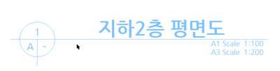

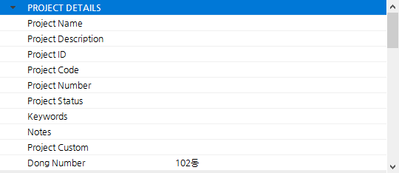

I want to use the ADD variable of PROJECT INFO in the drawing title object sub-type.
LeeJaeYoung
i use dong Number in Name Of Drawing
I want to use in Title.
dong number + title
now I make this title

Any autotext value can be written this way: http://gdl.graphisoft.com/reference-guide/autotext-guide
Drawing title is also available as autotext, so the simplest solution is:
text2 0,0,  "<Dong Number> <DRAWINGNAME>"
