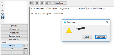

PS.PS. But we cannot access the "Configuration_Number" in the parameter script  ;( and that was my point...
Solved: EDU license serial number via AC API / GDL REQUEST - Graphisoft Community
AC27 on window 11
You can nake request in Master script and if ID matches proceed, if not - turn off parameters or smth like that.
Though, of course, it requires not EDU license

I don't think you can get a Graphisoft ID.
Just the Archicad license number being used - unless you have EDU or trial version - then you will get "0".
n = request("Configuration_number", "", stConfigurationNumber)
I'm not genuine, but the answer comes out as an empty space, but if you use it in the office, it should be genuine, so you can test this part then....

Works fine for me - I have a commercial license.
1. Do you have an EDU or Trial license.
If so this will not work, you will get "0".
