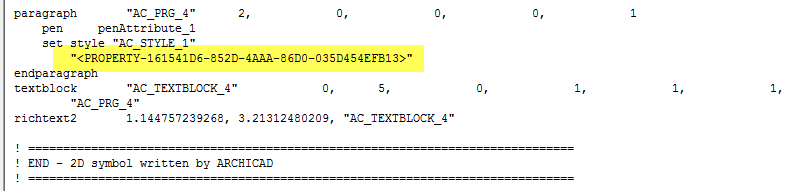

Simply place some autotext for the profile modifier you want.
Select that text and then 'save as a library part > label'.
It will create a label for you and if you open the script, you will see the code for the text.
It seems it refers to the modifiers by a GUID rather than a name.

I need more than just autotext access. I need to have conditional gdl code that does quite a bit and last time i tried, autotext is not available as a variable ie its an output string only...you cant use in gdl as such...
