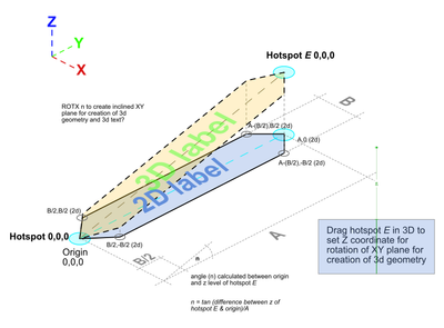

What I in effect want is to be able to define a 'slab' which will rotate in 3d (or 'tilt') when I move the editing hotspot in the z axis, so it looks something like this:
Without the circles and labels obviously.
The 3D text will be in a similar position to the 2D text if things work out - but inclined in the plane of the arrow. I want the 2D and 3D appearance to be ostensibly the same.

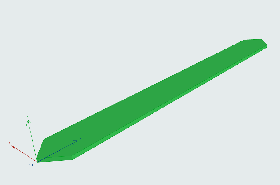

Jorge_Arreguin
working fine no problem, prism is the most simply solution, have a nice day

I'm really struggling with this.
I can create the 2d geometry and text and hotspot, but I just can't script hotspot 2 so I can move it in the Z direction.
This is what I'm trying to do:
Calculating the angle/gradient is easy enough, but I can't work out how to get what I have labelled as Hotspot E to be editable in the Z direction, and then I would have to read the Z coordinate to create the text value and 3d text rotation angle.
I really don't want to script the 3d geometry nodes by calculating them all. That's more mathematics than I have done for over 40 years, and I can do without that cognitive stress!
I'm not angling for someone to write the whole script for me, I won't learn much that way.

A_ Smith
You need kinda simple trigonometry
basic slope
AC 22, 24 | Win 10
Lingwisyer
Guru
The math for your 3 hotspots if you wish to go that way;
x =  ( ramp_length ) * cos ( angle_off_horizontal )           ! cosΘ = A / H
y = ( ramp_length ) * sin ( angle_off_horizontal )             ! sinΘ = O / H
z =  ( ramp_length ) * tan ( ramp_slope )                          ! tanΘ = O / A
Since you are wanting to insert x, y and z then use that to get your slope and rotate your object you can start with the following;
ramp_length = sqr ( x^2 + y^2 )               ! pythagoras
ramp_slope = atn ( z / ramp_length )     ! tanΘ = O / A rearranged
angle_off_horizontal = atn ( y / x )         ! tanΘ = O / A rearranged
Ling.
ps. You will need a hotspot for each axis you wish to move along. When stacked on top of each other, they will act as one with the correct math.

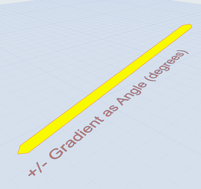

I managed to replace the PROJECT script with separate 2d geometry. That allows me to have different labels in 2d and 3d.
I've added the script for the 3d text, which works, but the position in 3d is wrong.
This is where it currently is:
The text anchor is centre/centre, at A/2 but the z point is the same as the base hotspot. I'll need to use some trigonometry to elevate it with an ADDZ.   
