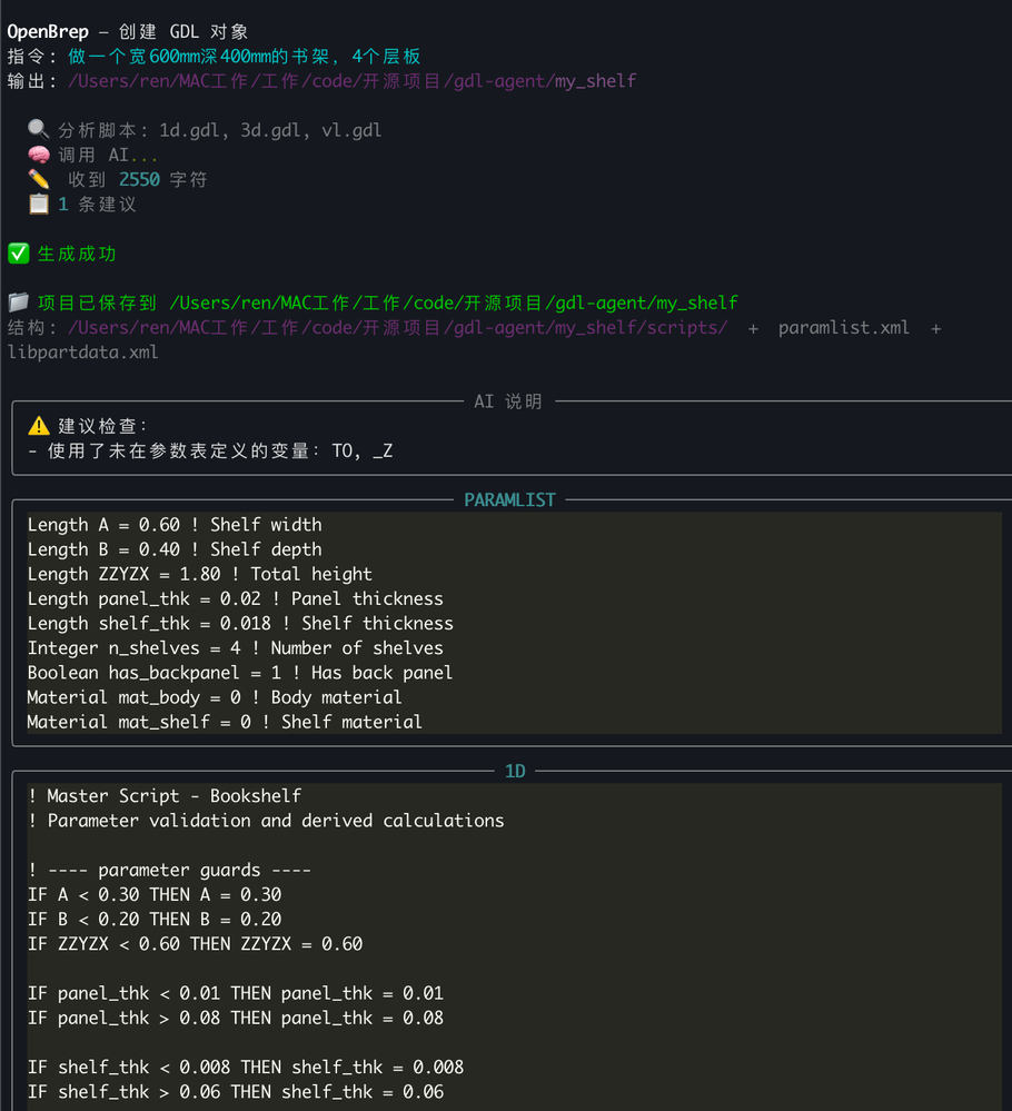

$ openbrep create "A bookshelf, 600mm wide, 400mm deep, 4 shelves"
✅ Generated: 3D / 2D / Master / Paramlist / VL
✅ Compiled successfully
Then you iterate — in the same terminal, on the same project:
$ openbrep modify ./my_shelf "Change to 6 shelves, evenly spaced"
✅ Modified: paramlist (n_shelves: 4→6) + 3D (spacing formula)
✅ 2D, Master, back panel: untouched

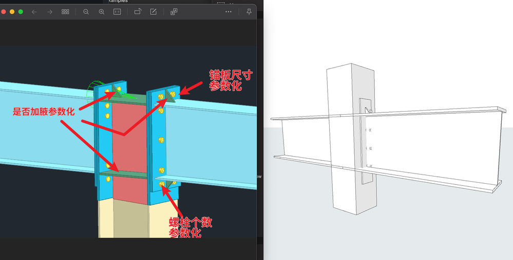

What works well: parametric objects (furniture, steel connections, simple building elements) from natural language, including from reference images.
