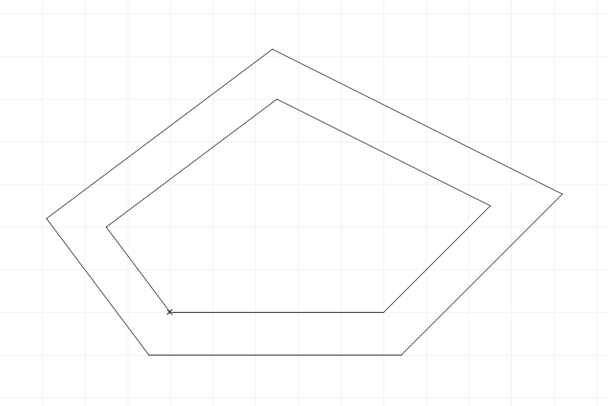

Does anyone have a simple example of using the "ResizeContour" command?  It can be as small as a 10'x10' box that is made 5' larger with the command.  I have been trying to understand the POLYGON OPERATIONS EXTENSION (GDL Reference Guide - page 647) without success. I wish the manual had included a simple example.
Thanks

John Edmundson
Thank you.  This certainly achieves the results I was after.  I have been trying to use the "DICTIONARY" (page 647) functions since they seem powerful for POLY objects.  I expanded your code to draw a POLY and offset it, and it produces the results I am looking for. Thank you.  If I can figure out how to use the DICTIONARY function, I will post the solution.
Expanded Code for offset POLY
