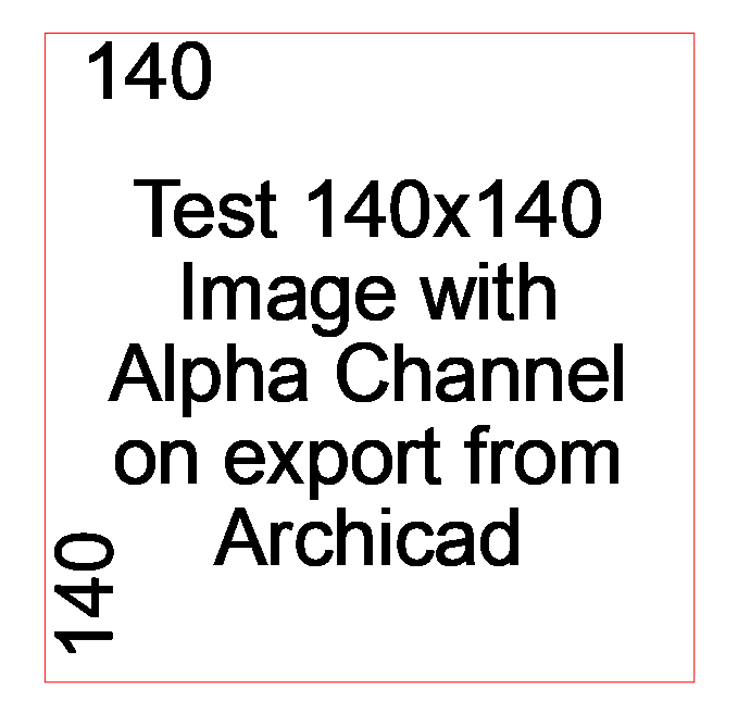

I am wondering what the work flow is for exporting an image from Archicad that has a transparent background that can be imported into the user interface.
I can export an images from AC with Alpha Channel, however all four standard AC export image types come through with a white background e.g. *png, *jpg, *gif & *tiff (samples attached).
Using the following code
ui_pict "Test_Image", 15, 15, 140, 140, 1
The images come through looking like this:
Also is there a way to set the size of the image on export - the UI_PICT function calls for a specific size. When AC exports it seems to export the extents. I thought adding the red boundary would be a way to control the size but there seems to be a white border beyond this.
Is this what other people do or is there a better workflow for this?

Your UI_PICT command is correct.
The 140,140 is the size of the image in the UI.
It will not crop the image, just resize it.
I have used .TIF with an alpha channel for my images.
I can't remember why I settled on that format, but it is what I use.
The alpha channel mask has to mask around the objects you want to show.
i.e. around the outside and inside of the red line in your image if you want to mask the rest of it.
I don't have my regular PC with me with my image software (just an old version of Paint Shop), so I can't really look at your images.
But any image editor should do.
I will attach one of my .TIF files so you can have a look at it (I have had to ZIP it as TIF is not allowed as an attachment).

Hi Barry, thank you, that is so helpful offering a sample TIF file. I will have a look. I was wondering how one goes about exporting the image from AC that might be different from what I am doing. When I export a TIF with alpha channel, I can't seem to find anything different in the image that shows it has an alpha channel. If it is not to much trouble, could you describe your workflow method of exporting the image in AC?

Hi Barry, the image you sent as a trial works perfectly. Okay so that is the process, add a solid background colour, export to photoshop, add transparency based on colour and then back to the Library for calling. Super great.
Just as a quick question, do you know if AC can export a TIF image file with transparency ready to go to save the intermediate steps? I don't know much about images but wondered with the export with Alpha channel option. It didn't seem to work for me but I wondered if I was doing something wrong. It would be awesome if one could directly save from AC. Thank you for your help, much appreciated!

I have never tried, but I just did, and although it says you can save a .TIFF file with an alpha channel, it didn't work for me either.
