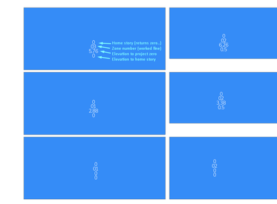

I wasn't able to put out the Story Number using the regular REQUEST command:
That index keeps returning 0 in whichever Story the zone is. (Also, the story name keeps returning the Story 0's name, which gives me a clue that Request is getting always a fixed story's info)

pedrocollares
Thanks a bunch! Zone number worked, but I guess I'll have some trouble to get the story number info.
Indeed, the story it puts out is the label's story. Tested it in floor plan and it works like so. In section though, the home story of the labels become invalid, always returning zero. The main reason for having such label is to use it in sections, so that generates me an issue.
As it seems, Home story index isn't available as a built-in property. The only way I see to achieve it would be making comparisons of the object's elevation to the project story configuration.
I'd have to run through a loop, discounting the elev. from home story and looking for a elevation match with some project story. But it should work, I guess?

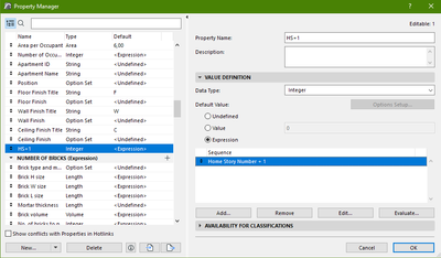

Peter Baksa
maybe a simpler way would be (without GDL) to create a property expression that calculates home story + N, and use that property in an autotext label.
Péter Baksa
Software Engineer, Library
Graphisoft SE, Budapest
