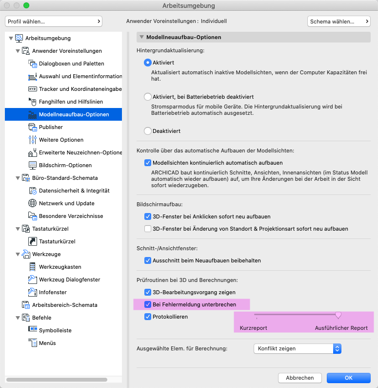

Hello,
According to this page: https://gdl.Graphisoft.com/reference-guide/output-in-an-alert-box-or-report-window
When you call PRINT "some text" the output should be seen in a dialog box or the report window:
Writes all of its arguments in a dialog box or the Report Window, depending on Work Environment (see the section called “GDL warnings”).
When I am calling PRINT "some text" there is no dialog box showing and going to the report window (File->Info->Session report) nothing is printed. The text i quoted above is referring to a section called "GDL Warnings", but that link seems to be broken. And going to Options->Work Environment->Work Environment I cannot find "Enable PRINT - statements" or similar.
Thanks

You can set something in the work environment. Attached is a screenshot of the German version. This settings activates the dialog box (AC 25) in the gdl editor.

I have also noticed this. I would be interested to know if there is a reason why it has changed?
