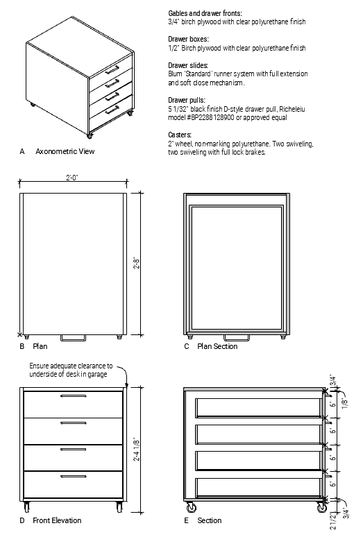

Hi everyone,
I'm developing a library of furniture/millwork objects for my office, and for each of them I'd like to use a subroutine to set up and position a section plane, to be used together with PROJECT2 to create the millwork details right from the object. (I can't use a macro in this case, because section planes created in a macro only apply to geometry in that macro). My objects should not be duplicating the same code, so my question is whether there's a way to create a subroutine library? I had a few ideas:
  • Could subroutines be defined in a master_gdl.gdl file? I would like to try this but the rather minimal documentation gives no details of how one is actually created - Archicad's gdl editor doesn't allow saving a .gdl file, only a .gsm object. And can it be used in the project's embedded library? Or does it have to be in an .lcf library file?
  • I suppose a GDL add-on could be written similar to Polygon Operations but it seems insane to do all that just to get a library of functions.
  • One could call a macro together with a 'sub' parameter, which will select and run a specific subroutine in the macro. Won't work with SECTION but might be useful otherwise...
The last option brings up the question of how macro calls relate to the different GDL scripts. With a bit of experimentation it appears to me that if a macro is called from a master script, then the entire macro is also called. But a macro call from a 2D script runs just the 2D script of the macro, and similar behavior with all the other scripts. Is that more or less correct? I can't find any documentation on this, but many GS objects seem to do this to set up parameters, or draw 2D symbols, for example.

subroutines can only be called from within the object.
The third option works well, you can return values from a macro or just PUT them if they are used for the same command.
Called macro's master script is always executed. A macro could be called from 2d in one object and from 3d in another, the master script is executed in both cases, the 2d and 3d only once each.

Thanks everyone! I will go with a macro to set up the cutting plane as Peter and Joachim suggest. I didn't realize that the stack is shared between the caller and the macro, that could be useful in all kinds of ways.
@DGSketcher
I really like axos, but the millworkers I work with still ask for conventional orthographic drawings. So I use the 3D views more as illustrations to help them understand a design. My hope is to set up a macro that takes care of all the 2D generation / section plane setup, and then the individual furniture objects should need minimal boilerplate code.
