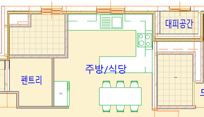

LeeJaeYoung
I made a zone stamp.
I put an on/off setting in it.
Created in unit.mod file and hotlinked to building A.pln
Here the on/off set in unit.mod works.
But when I hotlink building A.pln to All.pln, everything turns on.
How can I turn it off in All.pln?
it is unit.mod.
building A.pln
ALL.pln
AC27 on window 11

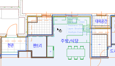

I suspect the problem is that zone categories are attributes, which get merged into the host file. If the zone category's default stamp library part is changed, it overwrites the imported module's stamps, and the parameters of those stamps reset to the default parameters. The same would happen if you changed a hotlinked line type.
Is it possible that another imported module overwrote the zone category that uses the custom stamp? Try using the same stamp for the same categories in each module, or use different category for different stamps.
Another option is using zone labels.

What you are saying is that it is turned off in building.pln where the mod is hotlinked, but it cannot be initialized in all.pln where the pln file is loaded.
AC27 on window 11
I am trying to say that it may be initialized to default in ALL.pln when the zone category attributes from two different hotlinks have the same ID but different zone stamps, or the attribute's zone stamp is changed manually after import.

I was asking how far the properties of hotlink can be transmitted.
Basically, the concept of link has been thought that the content of b is transmitted to the end. But Archicad wasn't like that. So, I decided that Archicad is designed as a single hotlink, and the properties of a can only be transmitted up to b. This is because the attribute a in a->b->c is not passed to c.
Question 1. So I asked if there was any way to pass up to c.
Because if not, I have to think a->b<-c.
AC27 on window 11
Yes, a->b->c should work.
Another possibility for error is changing the zone category's library part after placing the hotlinks.
We would need to see your files to be sure.
