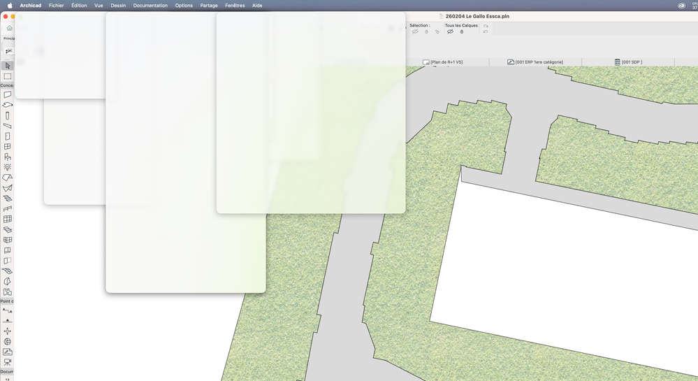

I found the way to create the bug :
Have ArchiCAD open on one of two monitors.
First, you have to "be" in another software (web browser, mails...) on your other monitor, and the archiCAD windows has to be "grey".  Then before clicking anywhere in your archiCAD windows, click directly on the dropdown menu. It will reproduce the bug.
You can even have several dropdown block like this (image)
Hopefully you'll find a way to correct it soon.
