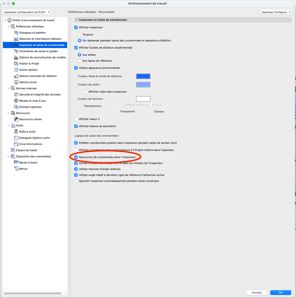

Hi Alexc,
Verify the "Inspector Shortcuts for coordinates" Checked box in your working environment, if unchecked Shortcuts won't open it..
ArchiCad 3.43 to 28
MacOS Monterey
Hello and sorry for not replying for a long time. I think I checked this and it didn't helped but I can't tell for sure now after so much time. In the end I sticked with opening key shortcuts menu and switching my keyboard language to english while the menu was open. Now there is a much easier solution that I marked as accepted solution. Despite choosing another solution I'm grateful for your participation.
