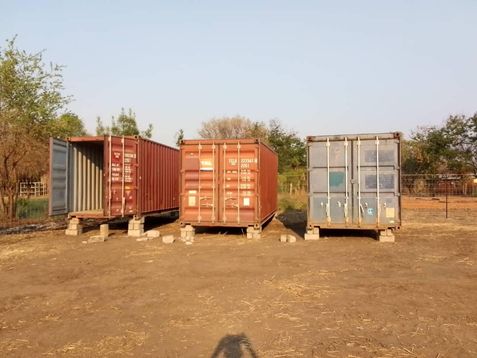

  • Pre-cast blocks are available on site to raise the containers off the ground

Attached images show the three 20’ standard height containers (but not the 40’ high cube), as well as an example of what they do with containers in this remote part of Zambia with an image of the assembly hall at the Mfuwe school… where the containers provide storage space, walls, and bearing for the trussed roof which creates a large well ventilated, yet protected, courtyard for meals, instruction, etc.

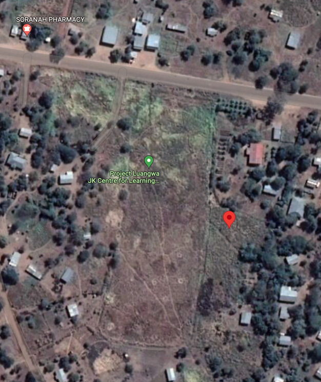

I just received the geocoordinates for the building site and have modified the original post to show them:
13°06'55.1"S 31°48'44.2"E
https://www.google.com/maps/place/13°06'55.1%22S+31°48'44.2%22E/@-13.1155649,31.8115745,580m/data=!3...
The site is to the east of the learning center building site.  Here's a satellite view from Google Maps as well as an annotated image from Project Luangwa showing roughly the lot allocated for the teacher housing...
