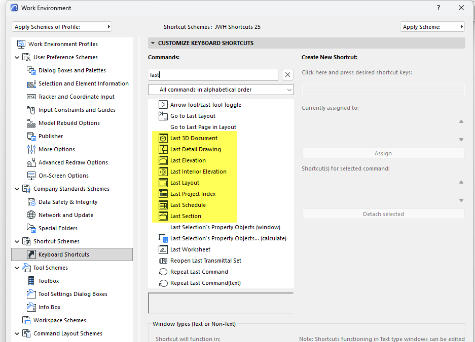

Since the last update my keyboard shortcut for switching to the previous view--say back to a detail from plan or 3D--doesn't work. It just toggles successively through all the open windows. I'd fix it but I can't find the command listed in Keyboard Shortcuts. Anyone know what it's named?

I found the settings you might be looking for in - Window - Navigate.
Maybe you can define your custom ones there.

Right idea, but no luck, thanks Cosmin. I've searched commands with "go" "back" "toggle" etc but can't find it.
How do other people do this: if you're in any window—plan, section, layout, detail, schedule, etc—how to you get back to the previous window you were just in? For the past twenty years I've just hit command-~. Now that just cycles me through every open window till I get back to the right one a dozen clicks later.

There are commands for showing last section, elevation, etc., that you can assign shortcuts for.
Personally I find it easier you just click on the tab itself or on the view in the view map list.
Or as Laszlo mentioned, there is a command for "Show Previous Tab".

I think what Geoff wants is the ability to switch to the previous active Tab, not the previous Tab in the list of Tabs.
If you have, let us say, 6 Tabs open, and you are on Tab 1 (Floor Plan), then you click Tab 5, which is a Layout, then the Show Previous Tab command will take you to Tab 4, not Tab 1, where you were before going to Tab 5.
So, unfortunately, there is no Show Previous Active Tab command in Archicad. Barry's suggestion may be the next best thing.
