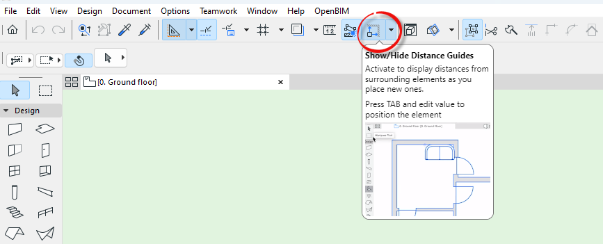

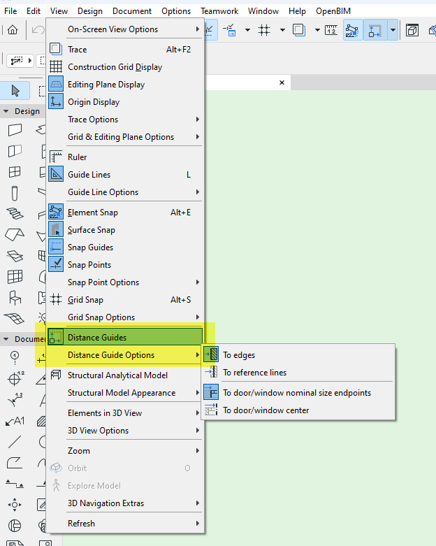

You can add the command to any of your tool bars and menus.
It might not be there if you are using your own custom Work Environment from an older version.
So add them to your WE or load a standard WE.
