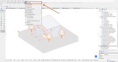

  1. You can also find it via Help > AI Assistant or under Window > Palettes > AI Assistant.

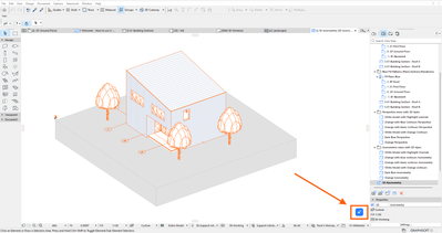

  2. After enabling it, the AI Assistant Action button appears in the bottom-right corner of the model space.

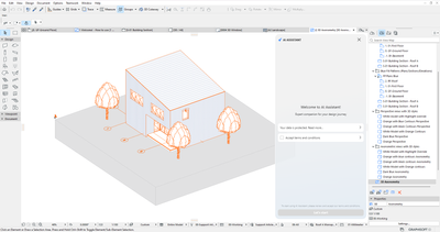

  3. Clicking on the icon will launch the Assistant’s interface. When the AI Assistant is opened for the first time, the privacy policy and terms of use are displayed.
  4. After accepting the terms of use, you can use the AI Assistant.

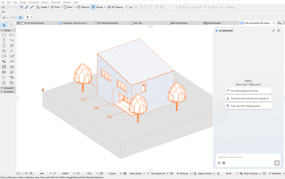

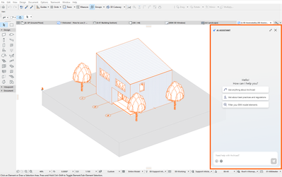

  5. Enter your question or command directly into the chat window and receive a quick answer or relevant options from the AI Assistant.

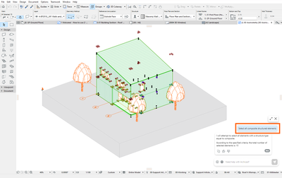

  • Filtering the BIM model by specific criteria
    The AI Assistant selects elements in the model according to given criteria, similarly to Find & Select.
    • Note: All 3D architectural elements, such as walls, slabs, doors, windows, objects, roofs, stairs, etc., are supported for selection. Elements can be selected in floor plan, section, elevation, interior elevation, 3D perspective, 3D axonometry, and 3D document. Selection can also be based on Archicad parameters.

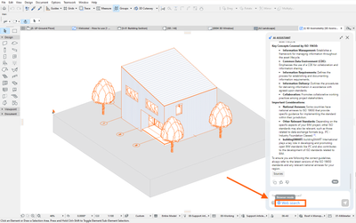

  • Internet search
    Enable internet search to allow the AI Assistant to research on the web as well.

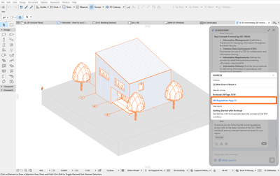

    • Sources
      All sources used to answer the query can be accessed via the Sources button. The sources are labeled to indicate whether they come from internal search or internet search. Click a search result to open the source.
