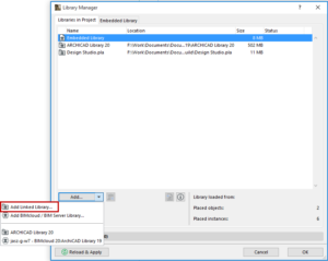

You can manage Libraries using the Library Manager (File » Libraries and Objects » Library Manager...). Let's see what are the most basic Library related operations:
When you add or load a Library, you tell Archicad where the Library folder is by defining the path to that folder. When you place an object, a door, a window, etc. in the project, you actually create a reference to an external file. When the Library of the object is loaded, the path to this file is known, so Archicad can read the file and can display the placed object properly.

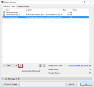

If you re-organize data on your computer, or server and move a Library folder to a new location, next time you open your project, you will have to re-load the Library, which means you re-define its location for Archicad.
This does not mean you erase the content of the Library. You only cut the connection between the project and the Library folder, so Archicad won't be able to read the content of the Library, so it won't be able to display placed instances of objects that were already used in the project. The reference to the external file in the Library folder remains in the project. You can re-establish the connection by re-loading the Library.
