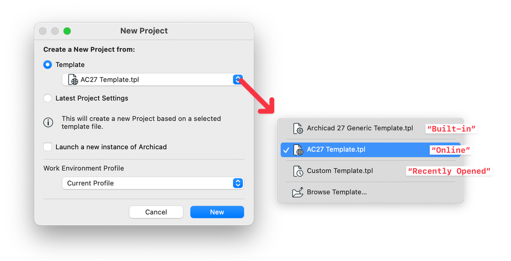

In the New Project dialog, you can choose between three types of templates under the Create a New Project From > Template drop-down:
  1. The Built-in Generic Template – marked with a gear icon. This is the default template installed with Archicad and is a clone of the INT template.
  2. The Online Template – marked with a globe icon. This template is downloaded from an online repository, ensuring you always have access to the most up-to-date localized version.
    • When Archicad is online, these Online Templates automatically appear and are selected by default in the New Project dialog. Once downloaded, they are stored locally for offline use, but updates will only occur when Archicad reconnects to the internet.
  3. Recently Opened Templates – lists templates that you have used or opened recently. This may include your own custom templates, templates downloaded from third-party sources, or templates from other regions that you have manually browsed for and opened previously.
