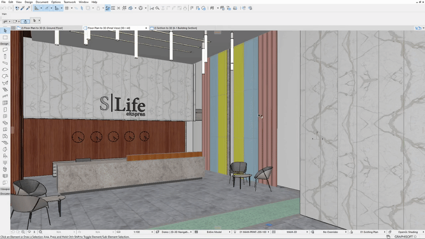

With the Select in 3D command you can switch between views while keeping the elements selected.
You can also control element's visibility and speed up your workflow when working with overlapping elements in 3D by hiding selected elements. This will make other building elements more visible without hiding their layers or modifying layer combinations. Simply right-click on the element you want to hide and choose the Hide Selection command. Save this custom view for later if you wish.
With the Select on Floor Plan command, the Floor Plan window instantly shows a close-up of the selected element in its environment.
You can use the Show All command to unhide the hidden elements and return to the original 3D view. Use this functionality in Sections, Elevations, and Interior Elevations as well. Now it is possible to track selected elements in any view, 3D or floor plan.
