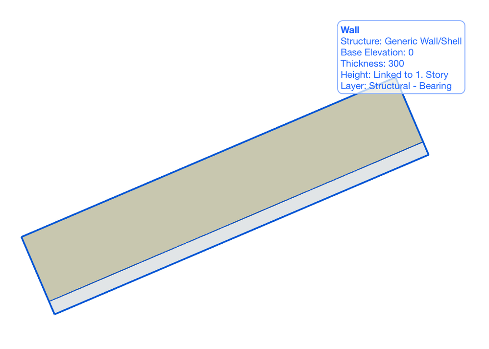

Preselected
  • hover the mouse over the element
  • element is highlighted in blue
  • Info Tag appears displaying basic information
