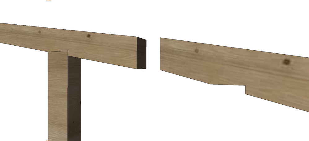

Modeling timber beams and roof trusses for joinery or fabrication often requires displaying exact cuts, notches, or connection details directly on the beam elements in the model. Instead of duplicating geometry or editing complex profiles, the Opening Tool can be used to create clean, parametric cuts that remain editable and display consistently in plans, sections, and 3D views while the beam stays a single element.

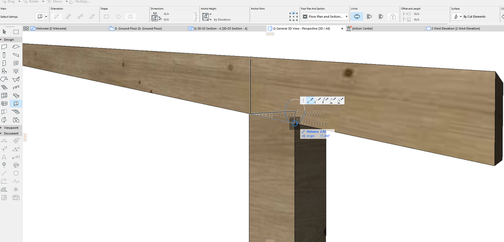

  1. Click on the Opening Tool
    • Access via Design > Architectural Tools > Opening, or select the tool from the toolkit.

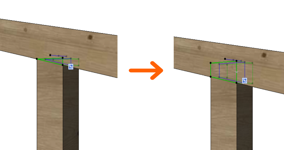

  2. Draw the opening
    • In the floor plan or 3D view, sketch a rectangular or polygonal opening across the exact spot on the beam where the cut is needed.
Once placed, the beam is cut precisely at the desired location. The opening remains editable, visible in all modeling views, and suitable for documentation, while preserving all original beam attributes.

This method results in accurate, editable cuts that represent joinery or structural details directly on beams. The workflow streamlines documentation and maintains a clean, professional modeling standard with minimal extra detailing effort.
