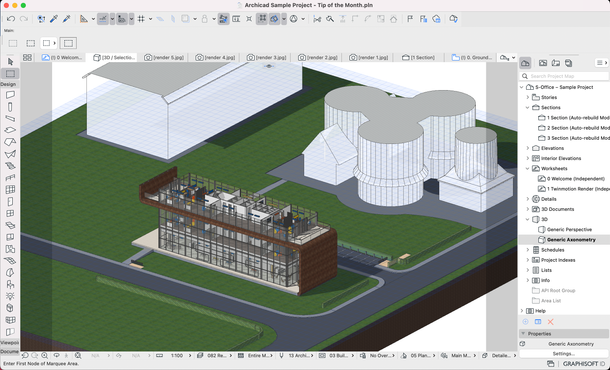

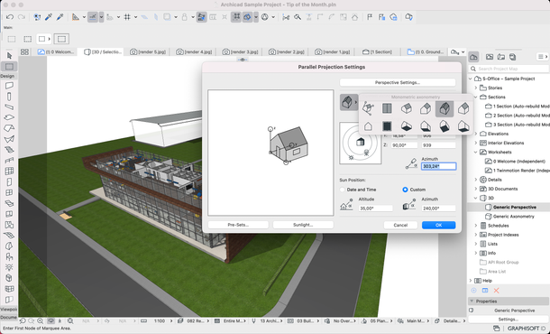

1. Activate a saved view in the 3D window and configure the desired axonometric view.
2. Switch to the Generic Axonometry viewpoint to retain projection settings.

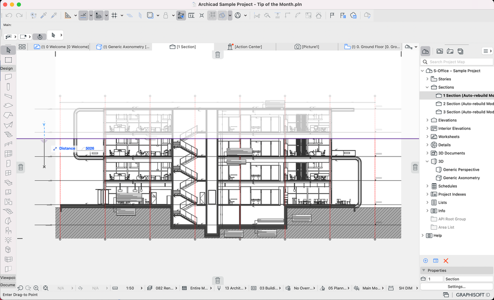

3. In a Section viewpoint, adjust the cutting plane height.
4. Return to the Generic Axonometry viewpoint. The updated cutting plane height is applied automatically.

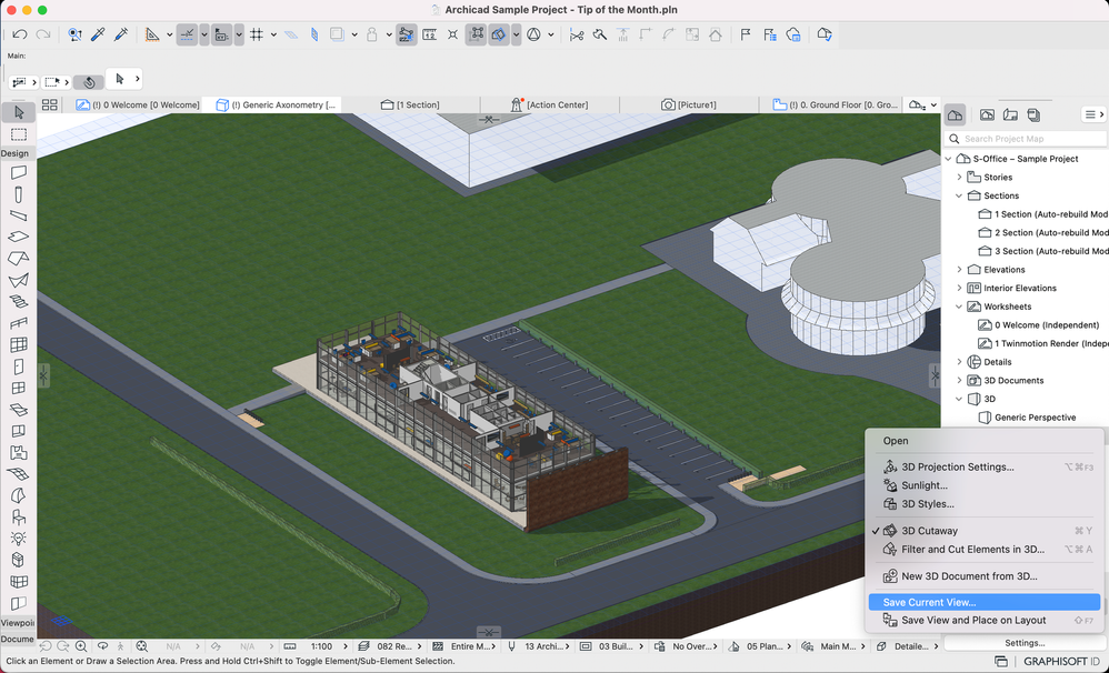

5. Save the view and repeat the process as needed for additional levels.
6. (Optional) Save the view for rendering in the PhotoRendering window.
