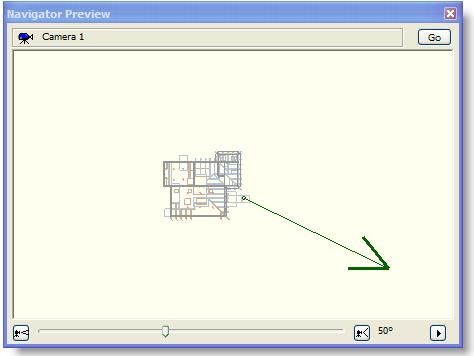

One may also change the rotation angle as well as the "height" using the Orbit command. For a perspective view, the Navigator Preview will show a miniature of the floor plan, along with an indication of the camera position (where you are looking from) and target position (where you are looking towards). You may move either the camera or target with the mouse, and will see the 3D view change simultaneously. You may also adjust the view cone angle with the slider at the bottom of the Preview window.
TIP: Sometimes it is hard to see the building plan and camera clearly because they are so small in the Navigator Preview window. The preview always shows the plan view with the currently visible elements (based on the current or last visited story, and what layers are turned on) zoomed out to Fit in Window. You may enlarge the Preview window by undocking it (grab it by its title bar and move it away from the docked or snapped position) and resizing the window. This will make the preview resize proportionately. You might also consider turning off one or more layers that have elements extending beyond what you need to see; for example you might turn off the layer for the site terrain mesh. After hiding the layer(s), use the Redraw Preview option from the popup menu at the bottom right of the Preview window.

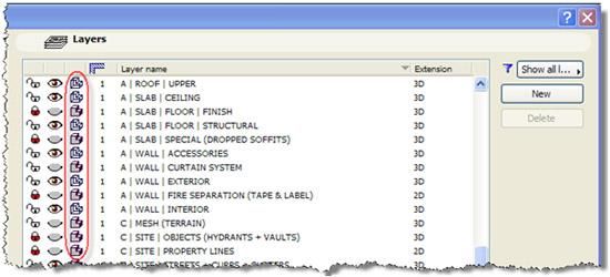

The main settings in this dialog (Wireframe/Hidden Line/Shade; OpenGL/Internal Engine) can also be chosen directly from the View menu > 3D View Mode menu. One or more layers may be shown in wireframe using the Layer Settings dialog (Document menu > Layers > Layer Settings or CTRL-L / CMD-L). Simply click the icon for Solid/Wireframe to toggle the visibility style for any layer:
Here is a view of a building with the layers for roofs and walls set to wireframe, and doors and windows turned off (the openings still show) in the Filter Elements in 3D settings.

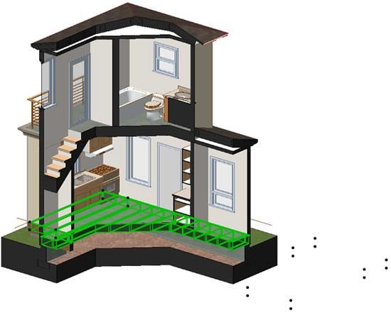

Even though a marquee will show only part of the model, all elements may still be selected and edited. When selected, cut-off elements will show handles beyond the marqueed area, to give a visual indication that only part of the element is visible (see image above). Note that if you move an element in 3D while a marquee is active, it is possible for the boundary to cut off part of the element, or even to prevent it from being seen in its new position (if it is totally outside the boundary). TIP: You may also select elements directly in the 3D window, then right-click or use the keyboard shortcut to Show Selection/Marquee in 3D—this will isolate those particular elements, hiding everything else. To see the entire model in 3D, choose Show All Elements in 3D instead of Show Selection/Marquee in 3D. This option can be chosen from the floor plan, or while in the 3D window. Of course, this will still only show elements on visible layers. There are additional controls available in the View menu > Elements in 3D View > Filter Elements in 3D dialog.

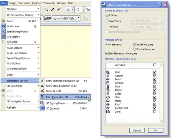

One may turn off categories of elements such as objects or roofs, which will simplify the 3D view, or restrict the view to only certain stories. When a marquee is used, the default Filter Elements in 3D setting is to show only what is within the marquee, trimmed like a cookie-cutter. However one may change the preference to show what is outside the marquee (so it can quickly "gut" the building). One may also choose to include the full extent of all elements in the marquee (rather than trimming them at the marquee boundary). One of my favorite tricks for working on very large and complex projects is to turn off windows and doors—then one sees simplified walls in 3D with cutout openings instead of actual windows and doors. This makes it much faster to work in 3D or elevation views. I also use this for previewing and testing animations and walk-throughs, since each view is generated more quickly but one still can get a good feeling for the pacing and framing of the camera path. Another special effect available in the Filter Elements dialog is to turn on Zones in 3D. Zones are frequently used to delineate rooms or usage areas on the floor plan, but can also be visualized as volumes in 3D for massing, blocking and stacking studies. Extrusion heights are set as in each zone's settings dialog. Zones may also be trimmed to fit under sloping rooflines using Solid Element Operations.

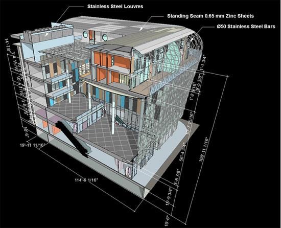

Graphisoft pioneers this year a new type of drawing, the 3D Document. The key innovations are that 3D views may be annotated (including easy and elegant dimensioning) and automatically updated (much like elevations and sections). Any 3D viewpoint may be turned into a 3D Document by selecting Document menu > 3D Documents > Create 3D Document. One may also right-click within the 3D window, making sure not to have anything selected, and choose Capture Window for 3D Document. 3D Documents are a new category in the Project Map, along with Stories, Elevations, Sections, Details, Worksheets, Interior Elevations, etc.
When creating the 3D Document, a standard dialog box comes up for setting the reference number and name of the viewpoint in the Project Map. The new 3D Document will have the same viewpoint (axo or perspective) as the original 3D window view, but it will be converted into a style similar to the Internal Engine. This means that it will not have textures (i.e. JPG versions of materials) but instead will have solid colors for the surfaces, with optional Vectorial Hatching and Sun Shadows.
Dimensions will snap to element node points much like on the floor plan or while editing in the 3D window. Three distinct geometry options in the Info Box allow distances to be calculated based on horizontal displacement, vertical offset, or along any plane (such as the edge of a roof). Dimension strings are "pulled out" from the model, with witness lines extending in accordance with the angles of the perspective or axonometric projection. Once placed, the dimension plan may be offset for graphic clarity, using one of the options from the popup editing palette. A full description of the special way that dimensions work for 3D Documents is available in the ARCHICAD Help system.
The 3D Document by default is set to automatically update whenever it is viewed, which means that it will always be consistent with revisions to the model. Dimensions will adjust as needed, as will labels that are linked to building elements. 3D Documents can be created from any 3D Window View, which means that they can include marqueed areas of part of the model, as well as 3D Cutaways. An example of a foundation cutaway using a marquee is shown below.
