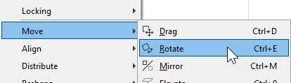

The “Rotate” command allows you to rotate elements around a freely selected rotation center. Just as at the “Drag” command, you first must select an element. Check How to Select Elements - The Marquee Tool , also How to Select Elements - The Arrow Tool to be more in depth how to select elements in Archicad.
After selecting the elements you cam invoke the rotate command
  • by right-clicking on the elements and select move > rotate
  • from the edit menu > move > rotate
  • by the pet palette and selecting the rotate icon
  • by the shortcut Ctrl+E on Windows, Cmd+E on Mac.

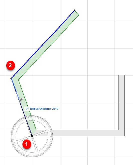

  • The first click defines the rotation center, which can be either on the element or outside of the element.
  • The second click defines the starting angle. In many cases, this click will be on an element edge or point.

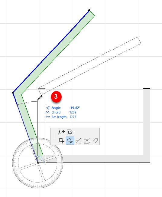

  • Move the cursor or enter a value at the Tracker to define the ending rotation angle. The next click (or the ENTER key) completes the rotation.

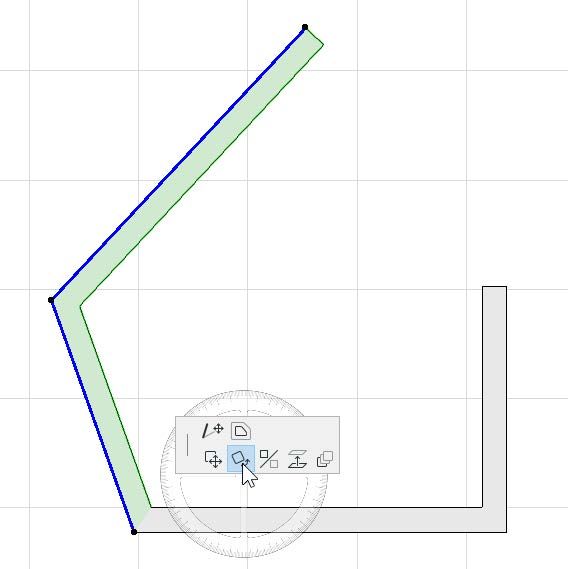

First, select the elements. If you click on it again, the Pet Palette appears. Within the Palette, the command “Rotate” is available. (second icon in the lower row)
Define the rotation center, the starting angle and ending angle.
