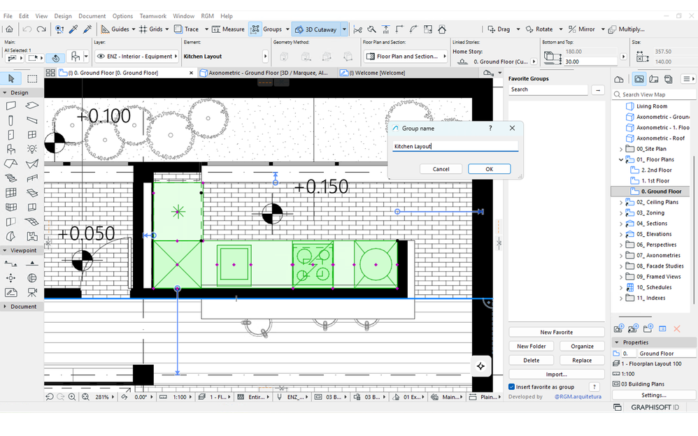

Step 2: Save a group as a favorite
  1. In plan, select the set of objects and/or lamps you want to reuse (only Object and Lamp element types are currently supported; other element types in the selection are ignored).
  2. In the Favorite Groups palette, click New Favorite and give the group a clear name, for example “Living Room Set” or “Kitchen Island Lighting.”
  3. The group is now saved with everything intact, including geometry, size, parameters, classification, and properties, identical to the original.
