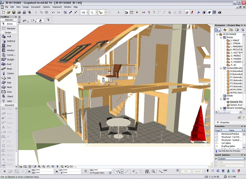

On my picture is shown what kind of a look do I get when I open 3D perspective view. When I move there, everything begins to cut, like in cutting plans. I don't know where is the catch to turn back to normal view in 3D, or is something else...

This happens to me, also, on occasion. And not only in Archicad 10, but also in 9.
In Budapest they call it the "Magic Invisibility Plane From Space That Cuts Off the Foreground in the 3D Window."
Sometimes closing the 3D window completely and rebuilding fixes it and sometimes I restart Archicad.
Boogle.
For a fly-through of this phenomenon, send a PM to me and I'll dropload the file to you - too big to post here.

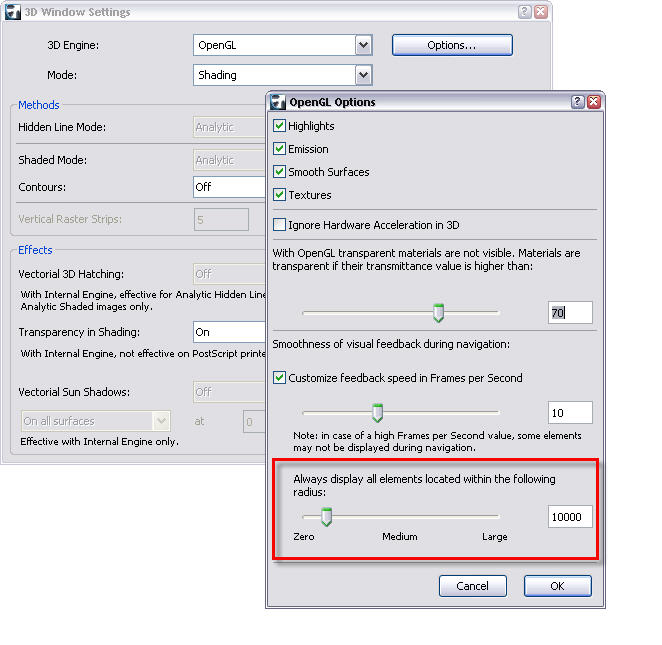

One more I've found in the 3d Window Settings options. But for me it doesn't help.
Rafal
I think the setting you have found displays items within the radius set, rather than excludes, which is the problem chipo is experiencing. That is, it will exclude items in the distance. It also pertains to display during navigation, so when you stop moving, items outside this radius should re-appear.... I think.
