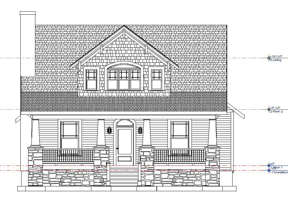

Rick Thompson
Hummm.. this is a fairly developed model, and my times are almost too fast to measure generating an auto build section/elevation w/vector hatching.
AC11 = 5 sec
AC12 = 3 sec (maybe) Opening again is instant.
AC11 = 5 sec
Thanks Rick, that seems pretty quick to me. I suspect you have done a really good job of layer management and only have the min stuff turned on to get the view (which is pretty, by the way).
