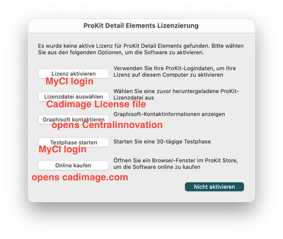

Here's the dialog I get.
All of these buttons go to Cadimage/Central Innovation (??????).
And chef's kiss: Clicking on "Do not activate" will crash AC (AC30-2026-10-10-19-30-46-2611).
