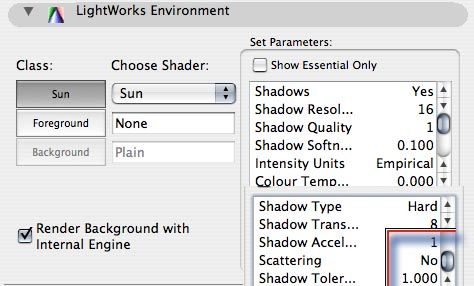

It is probably the tiles taking you over.
Try to render with one lousy sunlight to minimise RAM.
settings attached

Since the latest System update (10.4.9) Nvidia cards are supposed to work fine too.
The crash that occurs during rendering is probably unrelated to video cards. However, Lightworks is pretty memory-hungry, so a very detailed model might overrun the 4GB memory limit that the 32-bit nature of ArchiCAD and LightWorks imposes on us. For this reason, it does not make much sense to buy 8 gigs of RAM, unless you plan to run other memory-hungry applications along with ArchiCAD .
