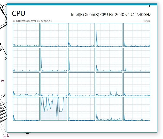

Thank you, you've just taught me how to properly monitor number of cores being used which is helpful. I see the same result here, panning and zooming seems to use more than one core. But look at my graph for cpu load attached. Most of the work is being done in my case by logical core 16 and it is constantly topping out. Maybe I am expecting too much here from technology, but why can't the load be split more evenly or across even more cores? What I'm trying to understand is why with such a seemingly high power machine the software seems so slow still?

I tried to search Dan's machine too (with the specs in his the signature), but did not find the exact system with the resellers online tools (https://www.scan.co.uk/3xs😞 Scan 3XS System. Intel Xeon E5-2640 v4 @ 2.40Ghz. 128GB RAM. Nvidia Quadro M4000. Intel 750 PCI-E SSD. Windows 10 Pro.
It might be a custom configuration.
Still, that machine (Dan G´s) should be quite a beast with renders. At least compared to mine: i7 2.93GHz, 4 cores, 8 threads. I would bet it actually is a really, really fast renderer with cinerender. It also probably would use every available processor thread with cinerender (both actual and logical threads), and that means 20 pcs with that Xeon E5. Renderings always benefit of cores and gigahertz.
Rendering algorithm should be a naturally and easily threadable task. That means the job can be divided in multiple concurrent, parallel, jobs to ultimately achieve only one unified result - the rendered frame or picture. I have been told rendering jobs are one of the most easily threadable, and in that way, the tasks that benefit the most from multiple cores of a modern workstation processor. The more cores, the better, the more gigahertz per processor, the better.
Unfortunately that's not what we get with every task in ArchiCAD. I would not say it's impossible to use every thread of a processor with every given task of a given program. Still, I believe it is very difficult to achieve, because of the nature of the tasks. Most of the common tasks would not easily be dividable as multiple parallel jobs, and thus use all processors or cores, to quicker achieve what would be correct and an acceptable result.
I am not a programmer, but I've had/got friend(s) who do that as a day job. I remember them/him being very enthusiastic of massively parallel computing and algorithms associated to boost computing, both personal and scientific computing. This all included, besides scientific astral calculations, some realistic rendering algorithms. Those very fine algorithms were not suited for the most of the everyday tasks, though. I don't know, but I think the same still applies today.
I have also learnt that GPU's (graphics processor units) are by their design and by nature something close to massively parallel. Thats why they too are being used for rendering tasks nowadays. And they seem to be quite good doing that job.
ps. I've got a 2006 Mac Pro Hack with 8 real cores (Xeon X5355, 2,66 GHz). By my measurements it's a little bit faster with rendering than my i7 iMac. Thats how and why I've come to a conclusion; real cores usually mean more real power than logical cores. So, a higher gigahertz might sometimes mean more than the number of logical cores. I would say as a rough approximate, that a logical intel core is worth 0,25- to 0,33 of a real core (within the same production year).

I hear what you are saying with regards some 'things' not being suitable for splitting across multiple cores. If that's the case then I partially accept that's just how it is - but it would be useful to have it clarified by Graphisoft. Also, it kind of suggests for day to day use you to buy the best performing single cpu you can afford right?
That's exactly what I have been thinking lately. We (our practice) should make an investment in workstations soon too. New 4GHz i7 seems to be a really good choice for price/performance and balance between 2D/3D.
