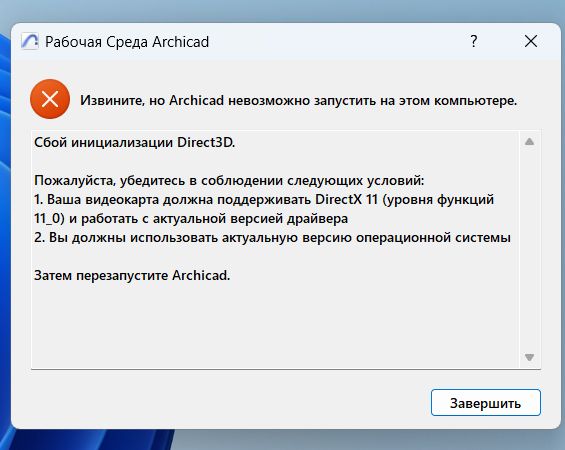

Hello,
How to launch ArchiCad 27 on Quadro FX 5800. Maybe i need to use some special patch?
Regards

@Vstar ,
It is saying your video card needs to support DirectX 11.
Does that card do that?
It also says you should be running the latest version of your operating system  (Windows 11).
Is that all up to date?

Hello,
Translate attached
Regards

Scott Boyd Turner
The FX5800 is a very old card (2008) and does not support Windows 11, the last driver issued was 2016.10.27 which has Windows 10 support.
Looks like you need to upgrade your hardware,
Scott
