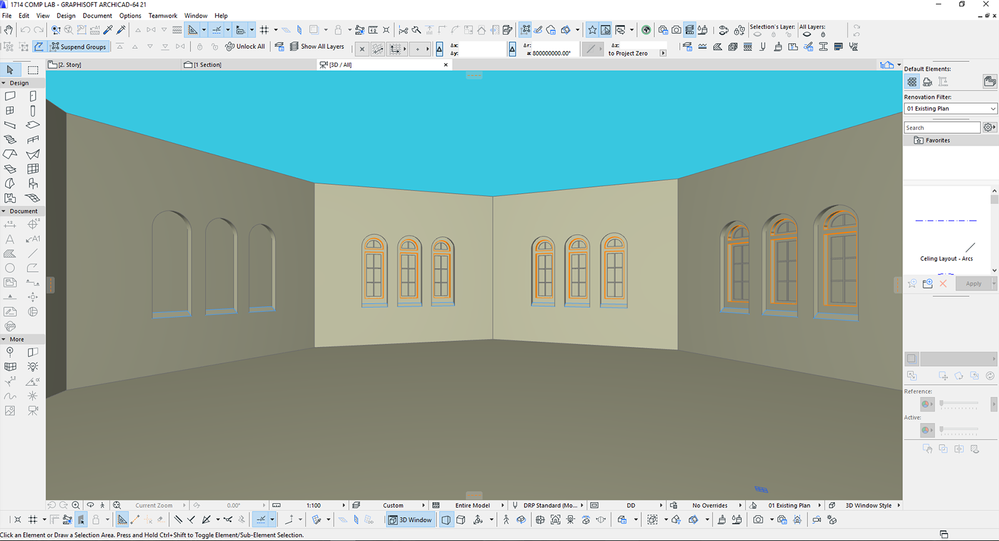

I have an issue with the 3D GDL and internal windows, in that all materials appear as the same tone. Even if I change the color of a wall, all are still the same tone. I do not have the monochrome model button on.
For exanple, the attached drawing has glass in the windows and transparency is turned on. All looks the same.

Check the Graphic Override settings, that is a possible cause.
You should revise your Signature to your Profile with your ArchiCAD version and operating system (see mine for an example) for more accurate help in this forum.
