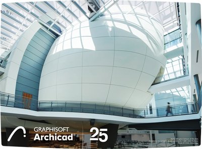

The "new" start up screen is absolutely useless.
In Win 11 Archicad 25 just at Archicad 25 hangs at Logo screen
for 10 minutes before user can do anything.
This is because it tries to list all recent files including .mod files.
I figured how to clear the list, or to skip the open screen all-together, but that's a nasty workaround, not a solution.
Could we please have an option to turn Open screen with recent projects it off?
At least give us an option to NOT LIST .mod files there.
Nobody in ther right mind should ever directly open .mod files.
Users generally should not even know that .mod files exist as a phisical openable file!
