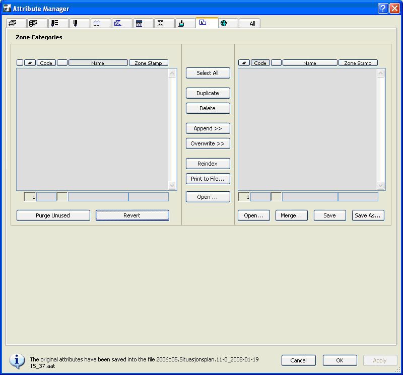

ArchiCAD (1114) has for some reason started to delete my zone definitions! That's bad, but even worse is that Attribute manager has a bug which prevents me from importing them back.
In this screenshot the Open button (and the others buttons to) will do nothing / doesn't' work. (The others Tabs works)
(As you can see the hole dialog box is also corrupted.)

No special steeps, just open Attribute manager ... happens again and again on my PC.
Workaround
Open the same file in version 970 and Zone attributes are back (just to disappear in version 1114 again)

David Maudlin
Rockstar
HAlm:
See this topic:
Zones being deleted
HTH
David
David Maudlin / Architect
www.davidmaudlin.com
Digital Architecture
So that is the source of the problem.
CadImage Tools again ...
They need to fix this now!
