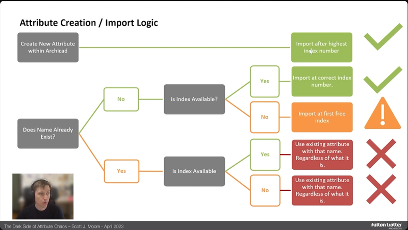

In addition to Berrys explenation i want to point you at a nice Skewd video titled "the dark side of attribute chaos" by Scott:
https://youtu.be/BbfFE3jr6rk?t=369
At 10:00 it gives a nice graphic about the imoprt logic of Archicad.
