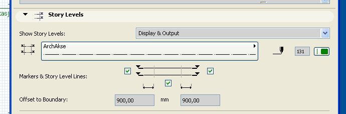

Update 2325 has created a new bug for sections.
I use story levels. Offset boundary for Story levels has been set to 900 mm.

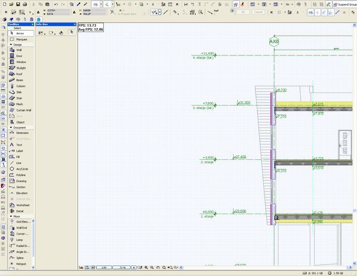

This is the original section. (OK)

Changing offset boundary for Story levels to 12 mm moves offset further out (it should of course move in / nearer the section boundary)

Changing offset boundary for Story levels back to 900 mm displays the (real) problem.
Is offset boundary now measured in “paperspace” length not in real world length? And then only after changing the given offset?
