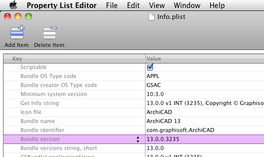

Marc, select the ArchiCAD app and right click to "Show Package Contents".
You can then use Text Edit or Property List Editor to open the Info.plist file.
It is here I add the version number to show in the menu.

Thanks guys.
I couldn't "see" HELP > LICENSE INFORMATION as I brought in my AC12 work environment profile with it's out-of-date menus.
And I never would have found it in the plist without Rod's map.
I wonder why they removed it from "About Archicad"?
