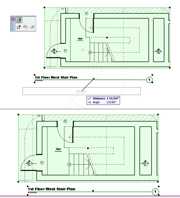

We are using a few very simple custom drawing titles for all our drawings on the sheet.
I usually am able to drag the title anywhere on the sheet I want it to be. I active the drawing and click and hold down on the anchor point, a little submenue pop ups and voila (I attach an image).
Now, on some files, I have the issue that nothing happens when I click on the anchor point, and the drawing title staus in its position without being able to be moved.
Funny as is, if I copy clip this drawing into a new file, it works again.
Copying everything to a new file is not really an option, since I have way too many layouts defined already.
Any smart ideas? I even take the not so smart once.
Thanks
Bjorn

Erika Epstein
It's a custom title that they are using.
Perhaps it has some legacy issues?
Do you want to post the title for people to look at?

First of all, let me say thank you for all the replies so far. Unfortunately I am not any further on this, but here is some more details/replies to the suggestions.
Erika wrote:
[...]Export the favorite and then import it into the file you are working on.[..]
No good either. Nothing changed, and again, it already works in some instances in the file and in some it doesn't.
zeropointreference wrote:
[...]Don't know the fix for it but a workaround is to select something else, like an element or something to get the pallet to appear for that object and then I go back and the pallet usually works.
Unfortunately, this won't do me any good either.
David wrote:
What is the name of the Title you are using? I don't see a Title that has the drawing number on the right.
Erika already answered this one for me:
Erika wrote:
It's a custom title that they are using[...]Do you want to post the title for people to look at?
I attached the title as a zip file with the original title. Come to think about it...Erika, this might have actually been created by you back in the days (might have been Karim as well though).
Thanks
