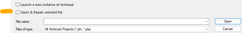

CosminF
You can try to open an empty Archicad, then go to file - open, select "Open & Repair selected file", and open your (allegedly) corrupted file:
