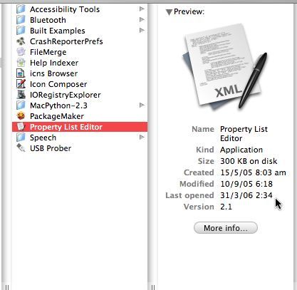

. . . or if you have apple's developer tools installed, 'Property List Editor' does the same thing . . .
~/archiben
