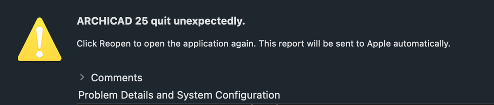

I have downloaded Archicad for my school work, but when I go to open the Archicad on my MacOS an error pops up saying "Archicad 25 has quit unexpectedly, try closing and reopening the app". I have tried uninstalling everything and installing it again but it doesn't seem to work. I have added it to the list of Full Disk Access but still no luck.

Which MacOS and what are your machine specs?
MacOS 14
MacBook Pro 2020
ctp0044:
If you mean MacOSX.10.14 (Mojave), AC25 requires MacOSX.10.15 or later.
