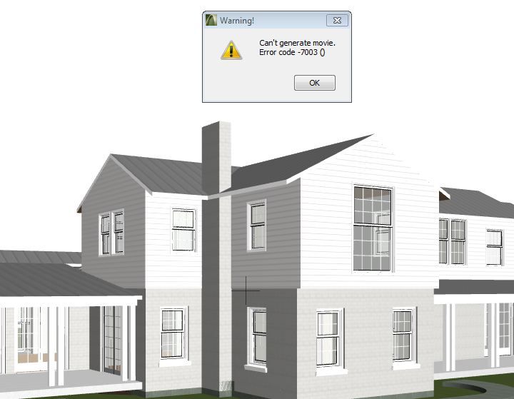

Hi! Good morning to everybody, I am still have the same problem when I try to generate a movie. Error code - 7003 O
Any help will be appreciated.
Why I am be able to save the movie on a desktop and no in a folder?
Thanks

Giuseppe,
we had a few similar reports over the past years. Is the folder where you would like to save the movie to on a network share? The not Pro version of QuickTime does only allow saving files to local folders. Also double-check the permissions of the target folder, if that is a local folder.
Let us know the results,
Marton

I think like you said only the Pro version of Quick Time allows to save in a network share folder.
I really appreciate your answer Thank you.
