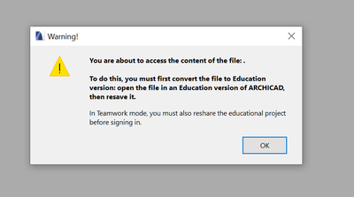

Recently my PC crashed and when I do the file recover it tries to open in education, says it cant and that I need to save the file in a education version and then closes. How can I force recovery to open with the commercial license. Or how do I remove the Education license because I have no use for it anyway.

To open a recovery file you have to start Archicad first.
Are you sure you are starting the commercial version and not the EDU version?
Commercial can open an EDU file, but it will automatically switch to EDU mode in the software.
But I am not sure if EDU version can open a commercial file (PLN) - which is why it might be asking you to convert it - I am not sure as I don't have an EDU license.
That is why I am wondering if you are actually starting with the commercial license.
Otherwise it sounds like a problem for your local Archicad support - assuming you have a support agreement with them.

It is starting Archicad in commercial, From the "Start Archicad" screen if I open a normal project it opens normally into commercial Archicad and works. It is when I open the red recovered files that it appears to restart in Education and I get the error.
Is there no way to remove the Edu license? If I uninstall and reinstall will that remove the Edu license and will I be able to still access the the recovery files?

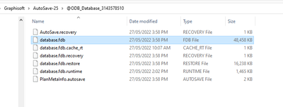

One other thing you can try is in your 'user' files you will find your auto-saved documents.
I don't think they are hidden.
Somewhere like this ... C:\Users\user_name\Graphisoft\AutoSave-25
Look for a file with the correct date (the time of the crash) that has an .FDB extension.
It should be a similar size to what your PLN file was.
COPY this file somewhere else and rename it and change the extension to PLN.
Try and open that file (it is just the PLN in disguise).
If that still tries to open as EDU, then something has happened to it - contact your local support to see if they can do anything about it.
I can't guarantee if that will work, but no harm in trying.
