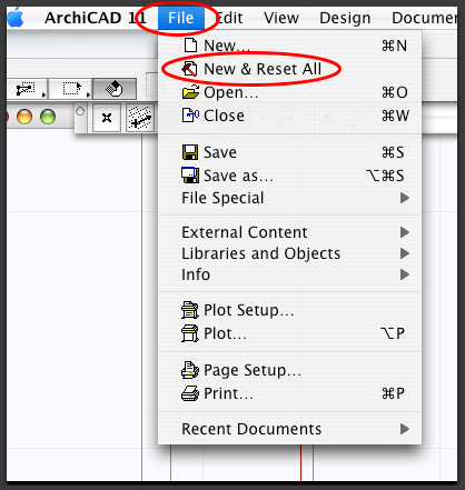

rslt wrote:
Do you mean from the start up menu? I selected a new document and 'default setttings'. Made no difference.
See attached, This will do what Laszlo suggested.
Rod Jurich
AC4.55 - AC14 INT (4204) |  | OBJECTiVE |
I don't have that option. I have 'new' but no 'new and reset all'.

Hold down the Alt button and it will appear.
Although I'm not sure it will solve your problem, because if a New ArchiCAD 11 Template file didn't solve your issues, this won't make any difference apart from resetting your Work Environment.
You have an attribute issue and it sounds like your previous project had a lot more/different attributes than what you see now. If you want those attributes back, go to the previous project and create a new project checking 'Use Latest Project Settings'.

Yes, Link is right, I should have written: "do New & Reset as the first step".
Some other things I would then try:
1. Quit AC, Delete Preferences, Restart AC or
2. Quit AC, Delete Preferences, Reinstall AC.
