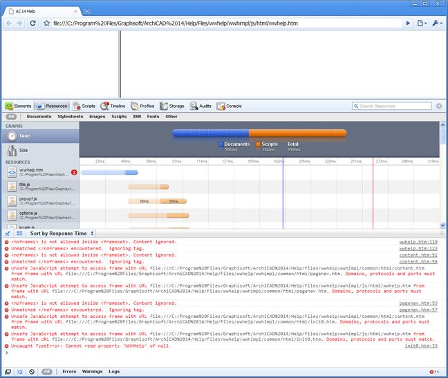

I am trying to use AC Help and have been frustrated with Google Chrome not displaying the content.
1. In Chrome, it not clear to me how to enable the java script, see screen shot.
2. Alternatively I uninstalled Chrome and then AC help would open a blank word document. HUH? How can I redirect AC Help to open with the browser of my choice?

Erika,
ArchiCAD Help will use your default browser. Maybe you don't have anything set after uninstalling Chrome? You can check it under:
Control Panel/Internet Options/Programs

Hi Gergely,
The screen shot is from a clean install of the latest Google Chrome.
Using "Set Program Access and Defaults" I clicked on the Firefox as my default browser. Started archicad and when I go to the
AC Help
Google Chrome opens up.
Still Empty
the other Help menu items in Archicad help open up in Firefox, always did, it is just the AC Help that opens up Google Chrome.
I can manually right click on the AC Help w here archicad is installed and choose Open with, and get it to open in firefox, but within AC it still opens with Google Chrome.
Sigh.

I got it!
Going to the installation location I right-clicked on the icon for AC Help and went to properties. There setting the open with to Firefox made the setting work as it used to be.
Ah, what a relief.
