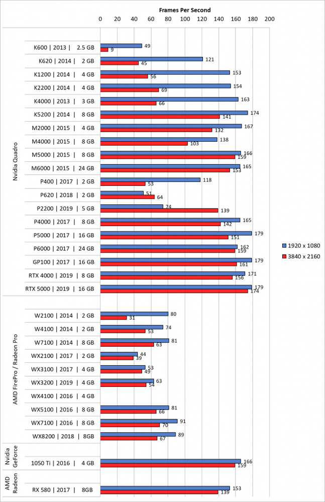

Graphics Card Tested with ARCHICAD 23
Here you can see the results on how different graphics cards performed on a reference computer configuration with different monitor resolutions. The measurements were done on a computer with CPU Single Threaded Performance  rated at 2194. The cards were tested with a small (250000 polygons), a medium (1,6M polygons) and a large (10M polygons) size project on Windows 10 64 bit. Frame per second rate shows the speed of the graphics card measured while navigating in the 3D window of ARCHICAD. Apart from graphics card's processing power, there are numerous factors that affect the 3D navigation performance.  The computer's processor (CPU) plays a major role during 3D navigation. The CPU feeds the graphics card (GPU) with data to process and display. If the CPU doesn't feed data to the GPU fast enough, you cannot utilize the GPU's full potentials. Thus it is important to pair a powerful GPU with an equally powerful CPU to mitigate CPU bottleneck.  Please note that 3D navigation is utilizing a single core of your processor. That is why CPU Single Threaded Performance is important for mitigating that CPU bottleneck. Another factor that will affect 3D navigation performance, is the monitor resolution. The higher the resolution, the higher the strain on the CPU and even higher on the GPU.  When the resolution is increased, the frame gets bigger and consequently the more processing required the longer it takes for the GPU to finish the computation. That is why the speed (frame rate) drops with higher resolutions. Another aspect often neglected is the memory size of the graphics card. When we open a file and navigate on 3D, the memory of the graphics card (VRAM) is used first, when it runs out then the Main Memory (RAM) is used. It is important to understand that your computer's memory is much slower than your graphic card's dedicated memory (VRAM) for 3D operations.  So storing data on the computer memory (RAM) for 3D operations is something that should be avoided. To prevent that from happening we need to make sure that our graphics card has enough memory (VRAM) available to handle our model. There is no rule of thumb to estimate how much memory we need. We cannot draw a parallel between the project file size and the graphic card memory usage. ARCHICAD stores the model information of the objects' parameters, and not by the coordinates of the polygons. Huge files that have a lot of parameters might occupy large amount of memory. And when the parameters of some geometry objects are set to large resolution or segmentation it adds an extra burden. Also there might be a model that itself is only just a few kilobytes, but its parameters would use up a big portion from the graphic card memory in ultra high resolution with lots of large textures triggering slowness.  We recommend 1GB of dedicated memory for average sized projects, but if your work involves UHD resolution monitors with large complex models,  your graphics card dedicated memory should be at least double.
Test Results - Windows 10
The following graphics cards have been tested for ARCHICAD 23
Small project (250000 polygons)

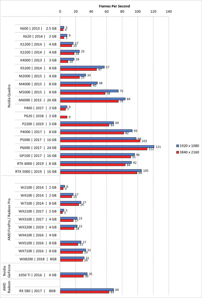

Medium project (1,6M polygon) - FPS ratio:
