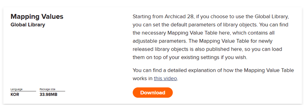

How to use the Mapping Values ?
Operating system used: Windows1.png
I want to install this feature and use it, but the linked video didn't give me a proper python file.
In another response, an Archicad official said that there will be a way to use it without installing the Python file soon, but I'm wondering when that is and when it will be able to use this feature perfectly.
linked video :
https://graphisoft.sharefile.com/share/view/s852df7d2f10f47708082f329e3cc32d8

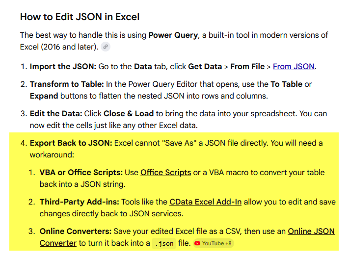

Did anyone figure out how to get it into Excel? Or any better way of editting that find and select in notepad...
I just googled "can excel edit a jason file".
There is a resulting AI instruction and a video link of how to do it.
I managed to open a file then imported the data to Excel for editing.
But have not yet figured out how to export it back to a JSON file.
Lingwisyer
Guru
I have figured out how to get is all into Excel using the Power Query Editor. Converted it to a table without delimiters. Expanded the features, then split first column that contains the parameter address using "/" as a delimiter. Now to see if there is a way to get it back into JSON...
Ling.
Once you have the date in power query, you need to 'close & load' the data into excel.
Where you can now edit it.
But you can't save back as a JSON file.
You must convert it as highlighted in step 4 above.
